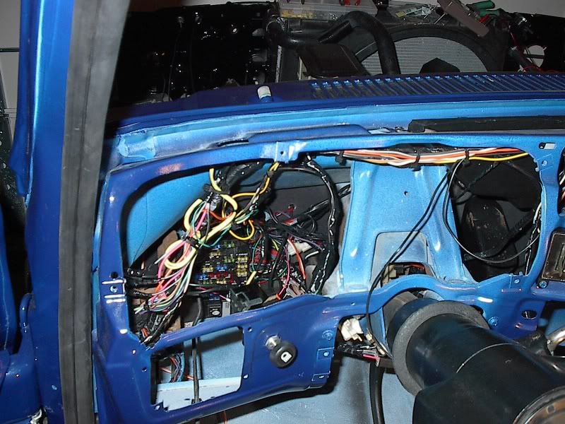

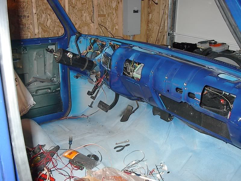

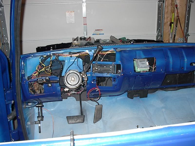

I am using a 18 circuit,  universal Chevy truck, Painless wiring harness that I bought from a board member over at fullsizechevy.com (I got it for 150.00 :P).  I am almost done.  I still need to attach the ends and to the distributor wiring and the fuel sending unit.  Then wire up the back lights and I'll be ready to test it out.  I ment to do a writeup on the process, but I want to do a writeup on the Dakota Digital install first.
The harness comes with the fuse panel and all the supply wires.  I still had to use many old ends from my old wiring harnesses.  I had to reuse the old interior, heater, horn and rear light harness.  They were in good shape still - just needed cleaned up.  I had to buy alot of crimp connectors and heat shrink tubing.  So far I have about 35 hours in the wiring, but it is starting to take shape.  Here are some pictures:
