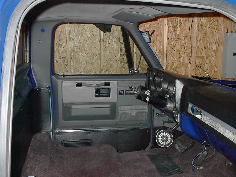

« Reply #52 on: April 07, 2008, 07:54:12 pm »
Update.....my interior is about done.

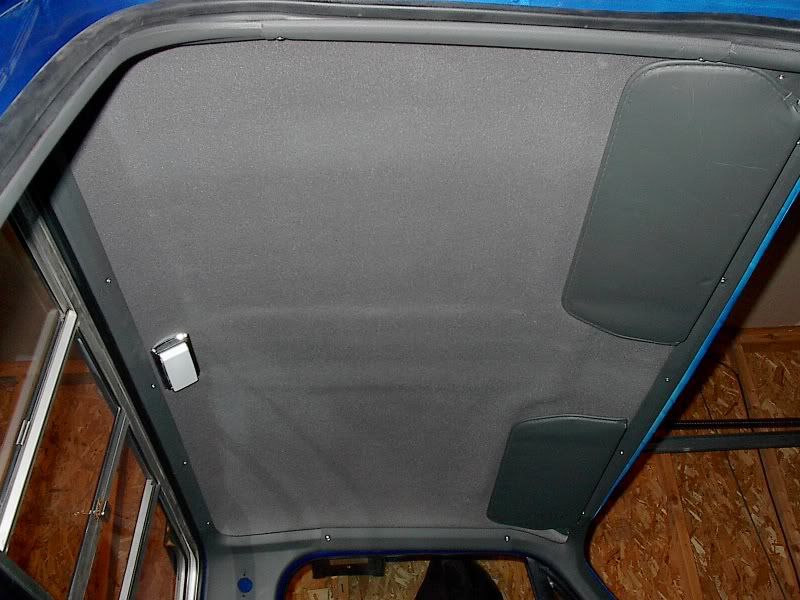

Headliner - I bought an old headliner out of a junkyard truck, pealed off the old liner and glued on new headliner.  I painted the visors with Duplicolor vinyl dye/paint
All headliner trim was pulled off a junk yard truck and cleaned and repainted with vinyl dye/paint.

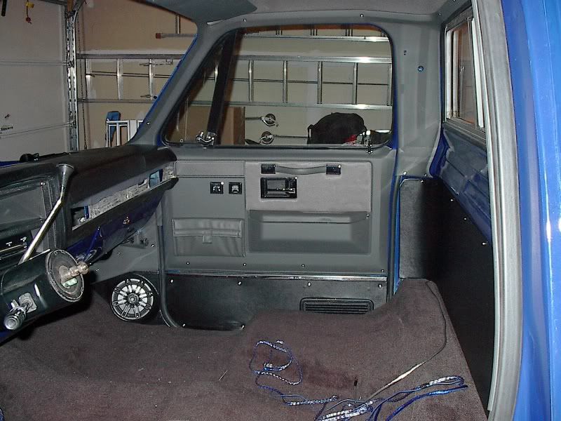

Drivers side.... The door is from a 91 Suburban with all it's interior trim.  I removed all the carpet, relined the carpet areas with grey headliner material and the bottom panel with black vinyl.  I also got power door locks and windows - all plastic trim pieces were painted with Duplicolor vinyl dye/paint.  The small trim piece at the top left was painted with Duplicolor wheel paint.
Drivers side door.....same as passenger side.  I reused the Suburban four gang window switches for now.  I plan on converting the four gang to two gang in the future - not a big deal for me right now.
Dash....is a dash pad bought from Chris on this site.  It fit pretty well and although would not pass as a show piece it is great for a daily driver.  I tried to recover my old dash myself but failed when I ripped the vinyl trying to streatch it.  I could have done it over but didn't want to spend anymore time on the dash.  With the cover, just some initial prep work, fitment and some trimming and I had the dash on in less than an hour.  I think it looks good!!

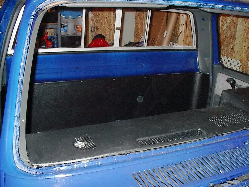

Back cab trim.... I made my own back cab trim with some luan board and chipboard covered with black vinyl.

Jeff, It really looks awesome! You're doing a fantastic job on this truck. The back piece is very cool! I was planning on doing something inside my GMC like that but hadn't decided yet...Maybe I'll copycat you! lol
Offline JJSZABO
  • Posts: 1009
Re: Update on Doors
« Reply #55 on: April 07, 2008, 09:07:29 pm »
Thanks guys ;D
Copycat away Vile - 5'-0" x 15 1/2inches piece of luan bought from Home Depot with some chip board bought at our local craft mart.  I used the chip board for the end curves.  One piece glued to the rear of the luan and one piece glued to the front of the luan to make a sandwitch sort of speak. Then glued on black vinyl.  I let everything dry and installed to the rear of the cab with some left over stainless steel fasteners.  I drilled into the metal that bridges the ridges in the back of the cab - if you know where I mean (this way I didn't drill through the back of the cab).  That's it - had it done inn about two hours.
