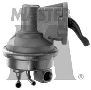

This is the fuel pump:
The instructions say to install the fuel pump pushrod and then install the fuel pump so the pushrod pushes the fuel pump cam.  My concern is with this step.  When I finished and then spun the motor I didn't feel or hear anything from the pump.
