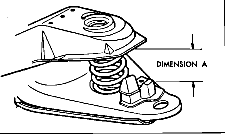

Measure from here and compare L to R

« Reply #34 on: April 10, 2008, 02:54:28 pm »
that measurement is : Drivers(L) 4"  Passenger(R) 5"

« Reply #35 on: April 10, 2008, 03:45:25 pm »
If those are different that is a problem...
Is the spring seated correctly?

« Reply #36 on: April 10, 2008, 03:58:26 pm »
yep, i cleaned the heck out of the lower and upper/CA's and made sure the seat was perfect. I went and checked the measurment again using a smaller device to measure with this time and it still 3/4" off from drivers to passenger side. So i am guessing that is a frame problem for sure? Will a frame place fix it @ that tolerance...... Not really sure about how much a frame shop will deal with before they say they are not touching it!

« Reply #37 on: April 10, 2008, 04:29:01 pm »
Due, If the spring is seated correctly, as you say, then you have one of the following or a combination of: A bad/weak spring (unlikely since they are new & the old ones made it sit crooked too), ALLOT of weight difference side to side (again unlikely), the upper spring "seat" in the cradle is damaged/humped upward or the spring "seat" in the lower control arm is dipped/bent downward. The frame itself isn't to blame when this measurement is off (on our Chevys truck anyway), this is a suspension/bolt-on  problem. Lorne

« Reply #38 on: April 10, 2008, 05:26:40 pm »
Was the measurement taken with the truck off the ground or on the ground?
If you want to rule out the springs as the problem, swap them left to right.
The spring has a location seat at the top, are they centered over that, or sitting on it?  If those measurements are off, I would suspect the spring or the lower control arm, but you control arms look ok...

« Reply #39 on: April 10, 2008, 06:22:27 pm »
I agree, it's not the frame my man, that's your crossmember and lower control arm. If it's an inch difference then either something is bent or you have defective springs if they are installed correctly. Swap em like Capt suggested.

« Reply #40 on: April 10, 2008, 07:02:07 pm »
I am starting to get the hang of this guys! When i put everything back in, i swaped the springs just cause i was curious! I will admit after cleaning the heck out of the uper and lower CA's the driver's upper arm seat did look i little bent(out of shape), but when i seated the spring in i had a tele-scoping viewer and as i used the floor jack to raise the lower CA and seat the spring i kept making sure it was correct top and bootom. I am 99% sure the spring are seated correctly.
  The measurement was taken with the truck sitting on the ground under it's own weight.
This cross-member ~ which one am I looking for(below oil pan,under cab,ect....) and i will post some pics and keep narrowing this down? Is there a way to tell if i have a bent CA without taking them both off and comparing them to one another?
Thanks guys for the continued help in my reoccuring question sessions!
1978 Chevy K10 / 454bbc / Dana 44 with chromoly axles / 6in susp & 3in BL / 38.50x15 Boggers(rims 15x14)!
Re: Need some help or suggestions
« Reply #41 on: April 10, 2008, 09:39:43 pm »
If you have a laser level you can make a point of reference from the front or rear of the crossmember and measure to the center of the lower ball joint. If it's physically twisted though you should be able to tell. I would give it a once over and if it all looks ok swap those springs.
« Reply #42 on: April 11, 2008, 05:28:15 am »
Wow, slow down there tiger!  In the pics it looks like the control arm bushings are shot as can be. Both sides are busted and hanging out and the drivers side looks to be totally gone. If that is the case then the lower control arm is teeter-totering on the spring. The bushing side is going down and the ball joint side is going up while the truck is on all four wheels. That could easily be 2" with the leverage/pivot point of the spring.
Put some new bushings and ball joints in it. Looks like it needs it anyhow, then recheck it.  Matt
