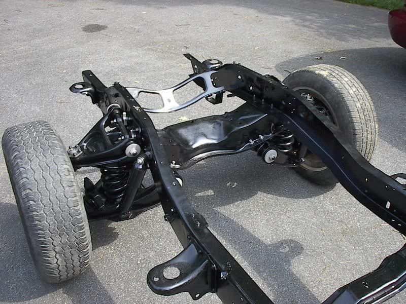

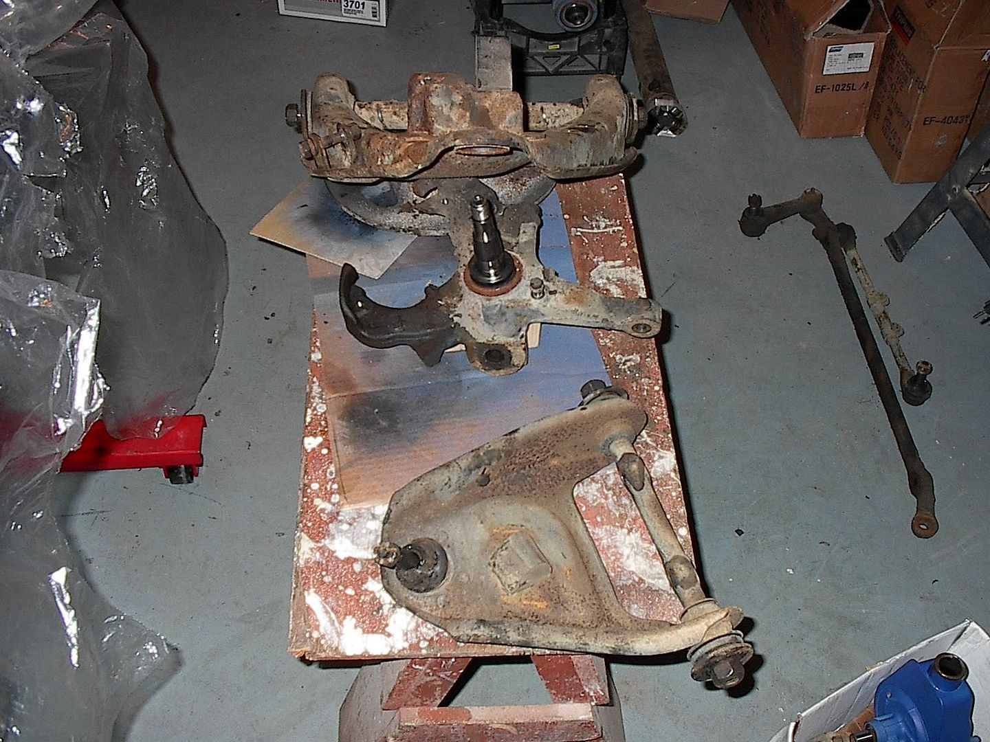

Here is what mine looked like before:
After:
I used this procedure for rebuilding my front end - I even used http://www.performancesuspension.com/ components.
http://www.73-87.com/7387garage/chassis_suspension/frontend.htm

Looks good. What kind of paint

« Reply #53 on: April 14, 2008, 08:27:24 pm »
Eastwoods rust converter, then Eastwoods rust encapsulator, then Eastwood's Chasis black.  It's Eastwoods chasis system.

Your came out looking awesome, good job and thanks for the pics and info!!!!!!!
