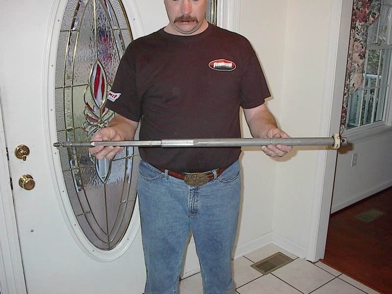

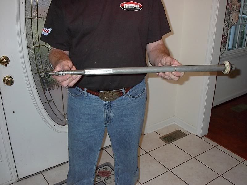

Well, the worst has been found.  I removed the steering column and removed the steering shaft from the column - it was collapsed. >:(
The two plastic pins were sheared.  The shaft still is "tight" when I pulled it back out - can I reuse it?  It will still collapse if the truck is in an accident (easier infact) - but the shop manual says to replace it if the plastic pins are sheared.

« Reply #5 on: April 10, 2008, 09:27:44 pm »
It's basically a hardened plastic that's designed to crack in an impact as to not impale or skewer the driver. There are also two brake away capsules where the column bolts to the cab with the same material. Now you are supposed to replace it in the event of an accident.. however being that it's your won truck if there is no play in it and you can make it work again, go for it.
