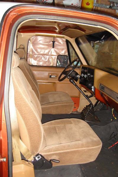

well since none of my interior panels seem to be the same shade i was wondering if anyone knew of a good paint or dye to use on the interior to get everything matched up?
heres a pic of the interior colour
thanks
