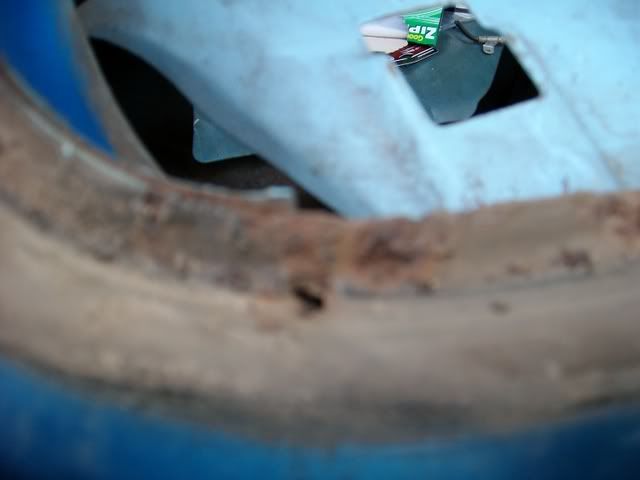

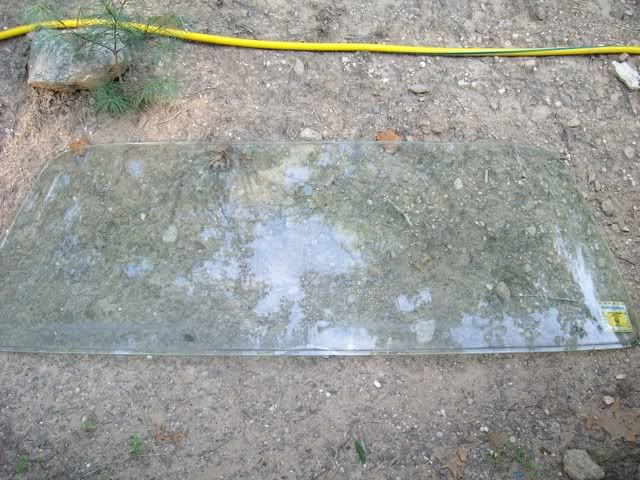

ok i got it i cut part of the gasket so i could get it out better and i did crack it in some places but i am going to get a new anyway and all i had was a razer blade and a screw driver and my two hands besides that it was my frist time so that makes up for the sloppy job ;D but i was right it was rusty so i am glad that i took it out.
                  is there supposed to be a hole in this area it is on the left

Are you talking about the drain hole for the glass?

« Reply #12 on: August 22, 2008, 02:12:10 pm »
thats it because there is one on both sides thanks chris

yes, there should be one on each side.  If they aren't cleaned out, the whole area could be rotted.

Thats what happened to my 1st  cab,
the p/o had the windshield replaced and they plugged up them holes with silicone and it rotted the entire lower portion under the windshield.I had to totally rebuild it and it was ok but the cab needed replacing so make sure them holes ALWAYS stay clear.
