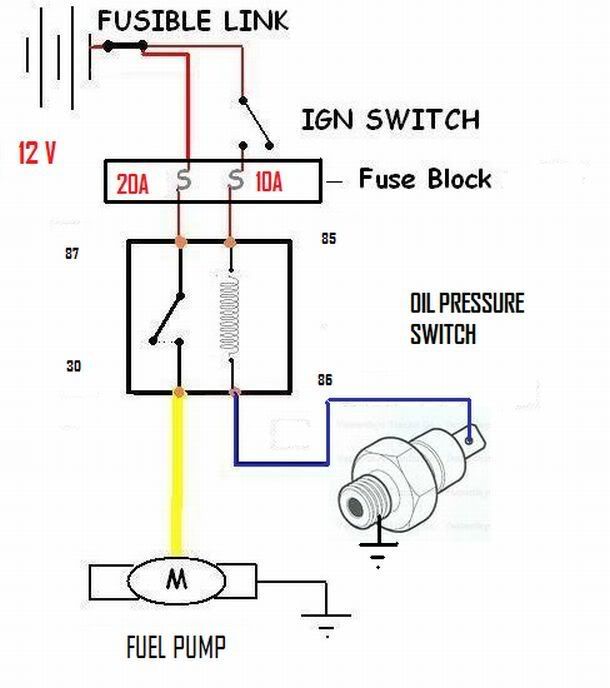

If you would like I can draw up a schematic for an electric fuel pump.

Here, I did one anyway

Now that's a Fuel Pump Cut-Off Safety Switch on the fly! :o  Starting to look a bit like Mister Wizard with Cooler Diagrams Vile! ;D
