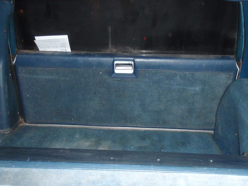

Hi and thank you for your quick reply. I do not see an access panel. Just the plastic and carpet over it I tried to pull the plastic off but ti would not budge. Where is this interior access panel at? have a picture?

I don't have a picture, the plastic bolts to the gate, the access is behind it.

So how do I pull the plastic cover off? Here is a picture of what im talking about.

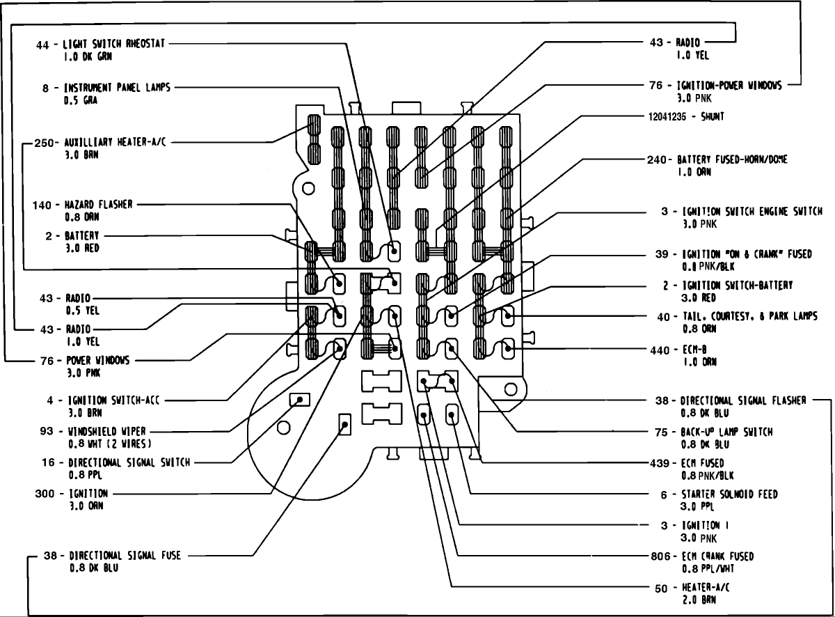

Thank you I found it. Dose anyone know where a fuse layout online is. I need to check the fuses.

vin # is 1gnev16k6hf166836 And thank you for the layout.
