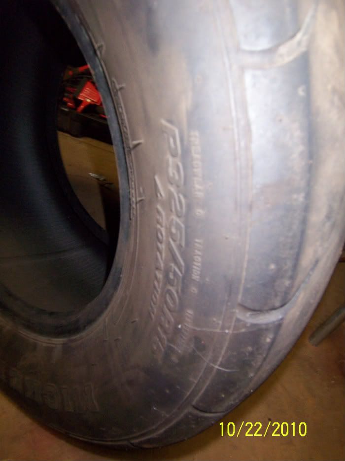

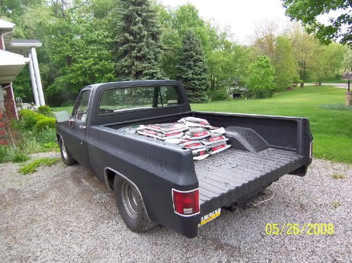

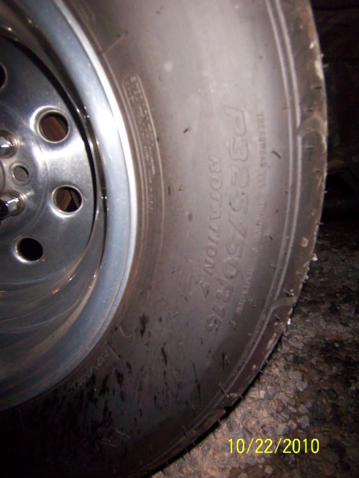

 Here is the Mickey Thompson ET Street radials that are on my truck today (mounted on 10" wheels) fairly new with 33 psi in them sitting in the driveway.
 Here is an old one that is "squared off" a bit after 100 passes or so & a bunch of miles
 I don't have any of the 315's to measure, however both Summit & Jeg's list them in the newest catalogs as being 11" tread width also. Is the one a 1/4" different in width than the other? probably.
I stand by my original unedited post. Lorne
