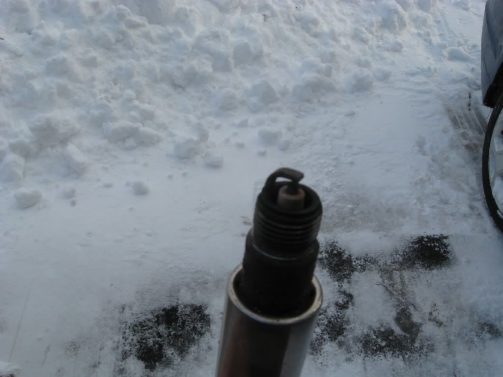

What does that spark plug look like?
Most likely it's in the valvetrain. Loose rocker, bent pushrod, flat spot on the cam, it's hard to say. I doubt it's your carb though, or it would affect more than just one cylinder.

i did a compression test on the cylinder.   it's at 110.   here is the spark plug from #6

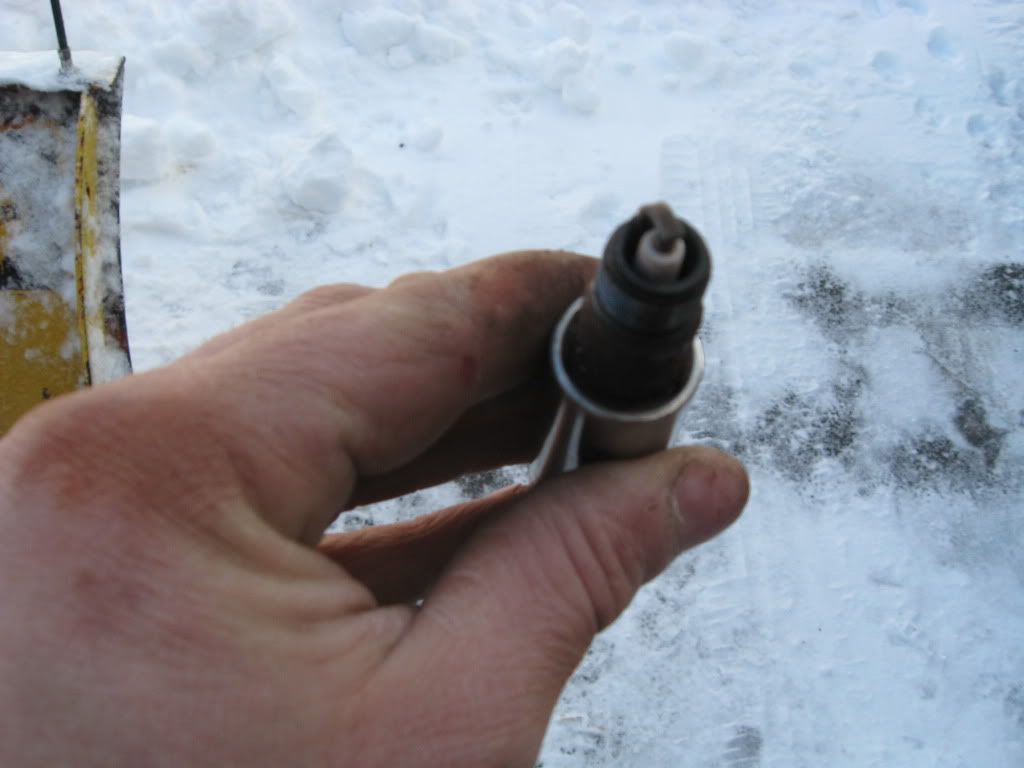

i pulled the plug on #4 as well and checked that one.   same, at 110.   plug from #4
