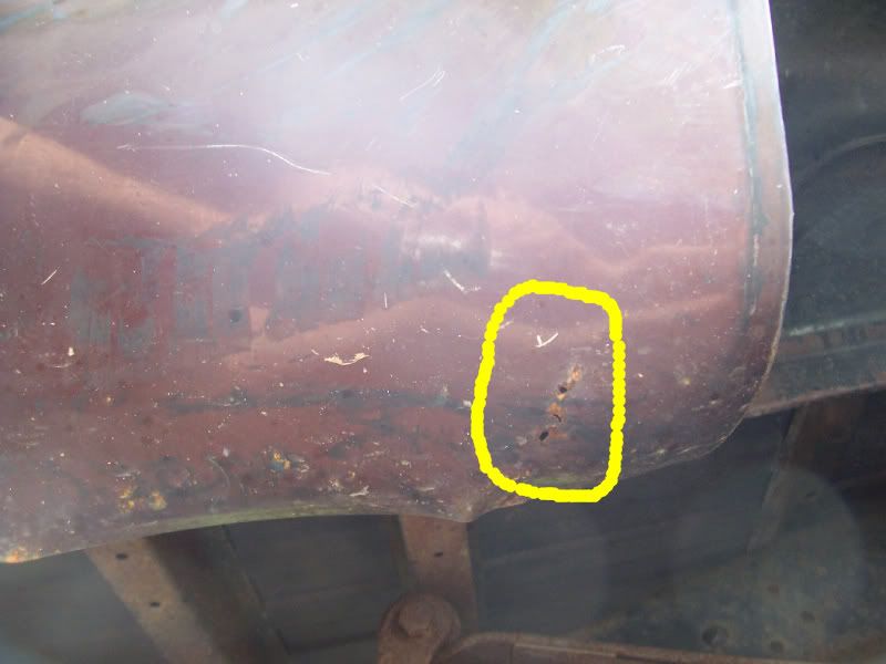

What's happened is that i did not want to attempt to fix it myself---one bodyshop did not want to work on it due to rust---i'll get into that in a sec.
If we can review, we see that the fender got bashed upwards by the separated tire tread.  If we could focus in on the yellow circle:
Note:  The paint IS NOT shiny---it was raining and this was the only time i had a chance to take a picture.

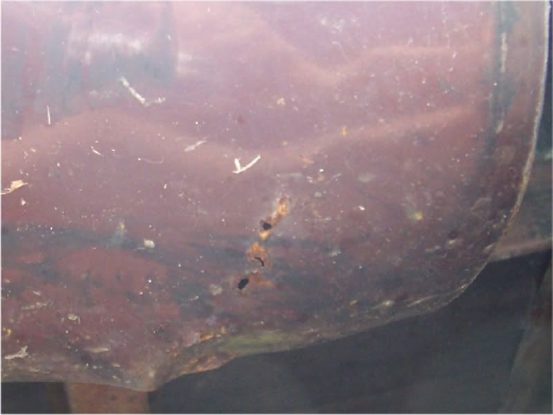

There are actually 2 small rust pinholes at the yellow circle area.  If you can imagine looking upwards from the ground.  i apologize that it is blurry.  i do not know if this was cause by the tire incident or were they there before?
What i DO know is that i would like to prevent further rust spreading until i can find a bodyshop.   i'm looking at por-15 but i read that it won't work properly on painted/coated surfaces.  i'd like to apply it on the inner side of the fender, but isn't there also a  coating or some rustproofing on inner fenders?
What's a good course of action here?
BTW i did get a new tire---a hankook optimo 727, but that's not important now.
P.S.  i may still try to fix it myself but right now the immediate objective is to neutralize the rust.

Re: Don't be too cheap---what an exploding tire can do to the quarter panel:
« Reply #22 on: October 13, 2011, 08:58:58 pm »
     I have used por-15 a lot.  But we have some stuff at work that is rust converter.  I can not remember the name right now.  All I know we use it all the time on old machines and we apply it right over the paint.  It works good for me.  As far as por - 15 goes, it is recommended not to apply over paint, it needs contact with the rusted area.
     If you want I can look tomorrow and post back.
« Reply #23 on: October 15, 2011, 12:34:32 pm »
     If you are interested it is called, Gempler's rust converter.  Hope this helps.

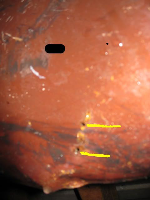

Here's a better picture of what we are dealing with:

The rust converter is very thin and doesn't stick very well at first.  Any suggestions on how to get it to stick?
i've tested it on flat(parallel to the ground) surfaces and it works well, but as you can see here we are dealing with an almost overhead situation.   i've tried spraying behind the fender as well, but it runs thru the holes.
Offline 1979C20
  • Posts: 1659
  • Kyle Taulton.
« Reply #27 on: November 01, 2011, 05:36:00 pm »
A piece of clear 2in packing tape on tge vack side, then spray then more packing tape on the front?
Offline Stewart G Griffin
  • Posts: 3324
« Reply #29 on: November 02, 2011, 12:55:46 pm »
OK, scratch that last statement----it does work-----i apparently did not give it enough time to dry;  i had sprayed it at about 5pm yesterday and now it's all pretty much black.  So i guess it does work---even on "overhead" situations.
