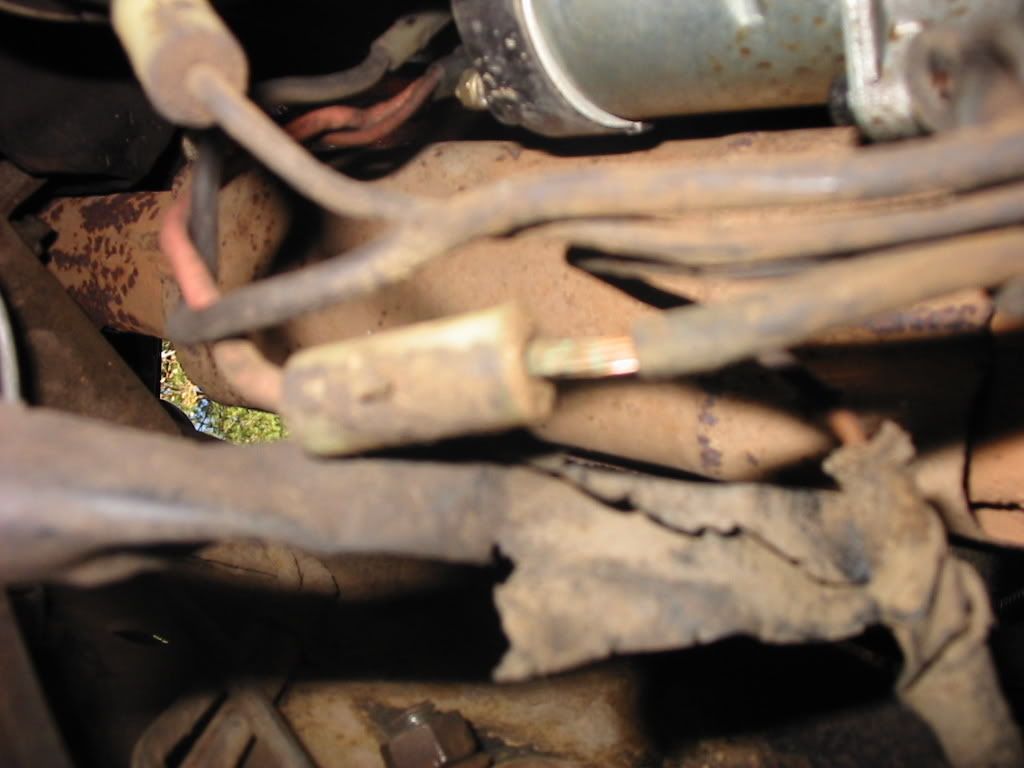

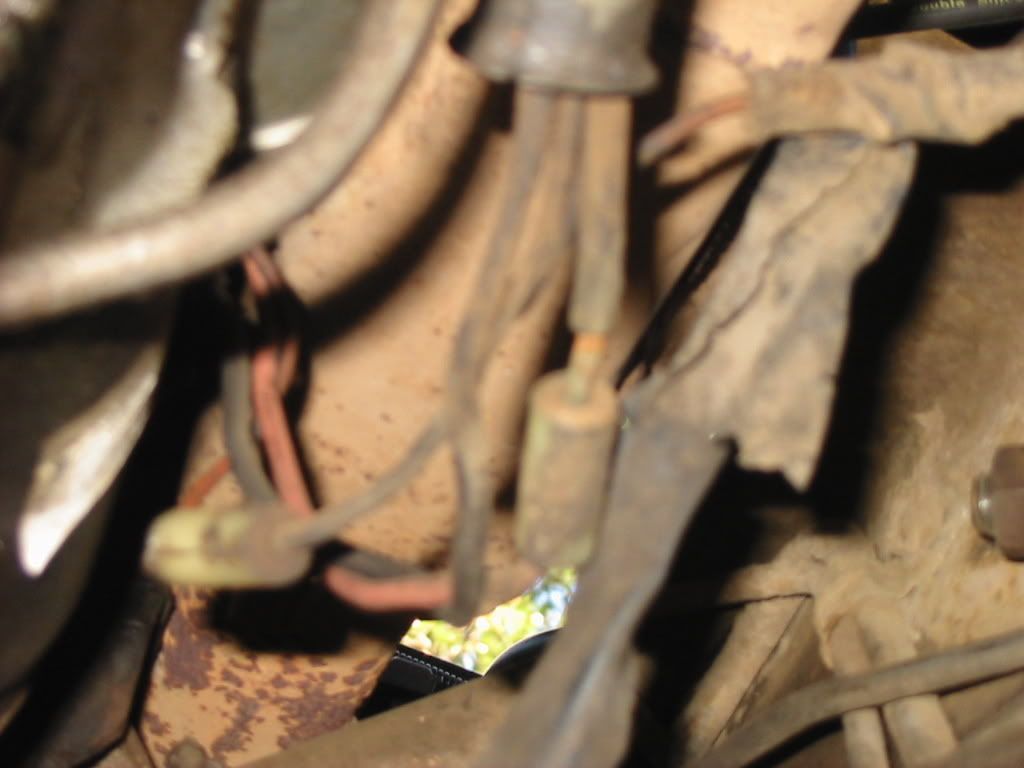

« Reply #21 on: November 22, 2007, 02:00:00 pm »
Here's what I visually found  ;D
Looks like a fusible link that was pulled out or maybe it was blown and pulled out.  I don't know if it even has anything to do with the charging system, but it looks like it needs to be replaced anyway.  Thanks, does that look like it's the problem?

« Reply #22 on: November 22, 2007, 02:01:24 pm »
I'm so sorry for the crappy pics.  Not my camera.  I should buy one just so I don't have to use that piece of crap any more.  Happy turkey day!!! ;D :)

« Reply #23 on: November 22, 2007, 02:03:02 pm »
That looks like the symptom. The problem would be what caused it to melt. Check the wires all the way back around the valve covers and make sure nothing chafed through and shorted to ground. Once you locate and repair the problem replace your fusible links that are toast and locate them away from the exhaust.

« Reply #24 on: November 22, 2007, 02:20:28 pm »
They didn't look melted at all.  That one was just sticking out of the fusible link and has some corrosion on it.  If you look at the top of the second pic you'll notice a tube for the wires to go in so they don't touch the manifolds.  It wouldn't hurt for me to check either.  Also, I didn't realize how big the starter was and didn't know the relay or block was right above the starter (looks like a pain to replace).  I will check.

« Reply #25 on: November 22, 2007, 06:00:04 pm »
That's the starter motor solenoid. It's mounted directly to the starter. Check those wires behind the valve cover and make sure they didn't chafe through. Make sure you replace the fusible links. If you search here you'll find a few posts on how to replace fusible links.
