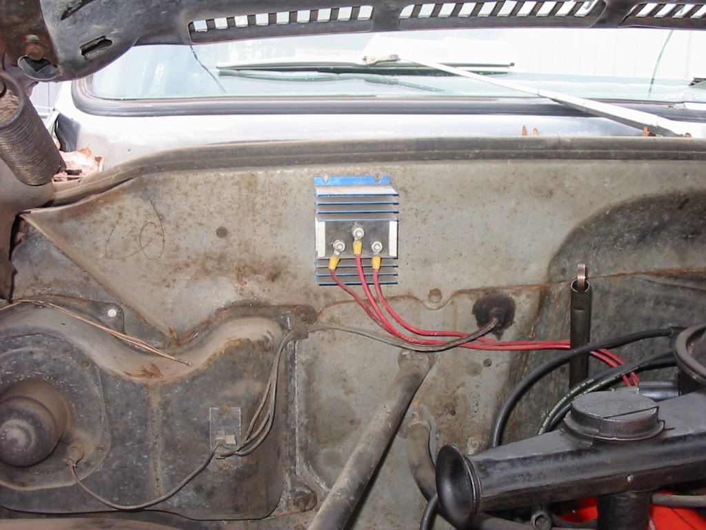

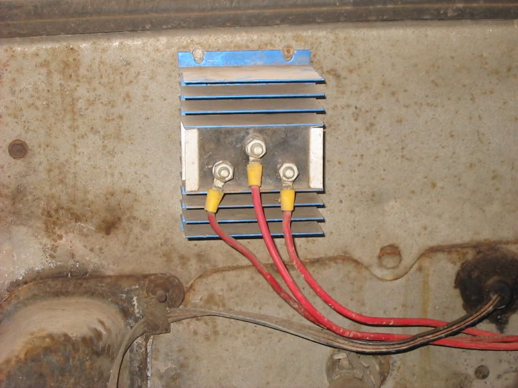

Here's my problem.  Here is where the wire goes.  It is the one in the middle.  The one on the left is HOT, and both the middle and far right were barely lit up while running.  Now, I am not sure where the one on the far right or the one on the far left goes.  Or, if the thing is even working.  I don't know what it is, is it a junction block?  Thanks
Do I trace the wire (the far right one) and find where it goes?  The wire in the middle to the alternator is fine, it shows little resistance.
Hmmmm... trying to follow this post maybe I missed something here but did anyone else see any mention of a dual-batt setup? Looks like that's what you're seeing there in the photos; a battery isolator. Had one on my '77 camper and eventually it went bad. When they're new they work fine providing you followed installation instructions but they won't last forever you know...
Re: Cheap re manufactured crap!!!
« Reply #43 on: November 25, 2007, 10:40:39 am »
Yes that's an isolator like you'd use in a boat or a camper etc. That's not a factory junction block. The factory junction block was on the firewall and football shaped.

« Reply #44 on: November 25, 2007, 07:09:32 pm »
Yes.  Am I supposed to have both batteries hooked up?  My junction block is on the other side.  And I know what it looks like.  I was just trying to figure out why there was no power, and from there where the wires went.  What do you recommend doing?  Should I see if I am getting power out of the junction block, then see if I am getting power at the end of the wire?
