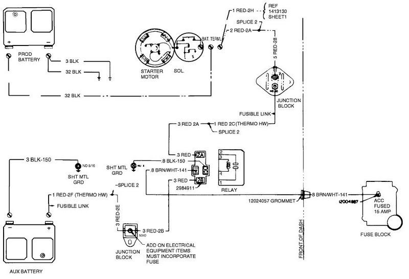

Here's what I think I might try....I'll mark each wire at the junction block (the passenger side one for a spare battery) and connect the wires together using a bolt or screw.  Then, I will see if that works.  What do you think?  I am getting power into the block but the other two aren't?

Are you running dual batteries like for a camper or something off of your truck? if not you can run dual batteries in parallel and ditch the isolator or go back to single battery. Those are basically designed to prevent you from draining down your primary battery. For a quick test jump those terminals together with a jumper wire or put them all on the same peg and see what happens.

O.K, I put all three wires on the same post and it wouldn't even run.  I could barely get it started then when it was started it was shaking really bad and then died.  So, what should I do next?  Should I test the wires?  Thanks

What is connected to your factory junction block? I think you should hook it back up the way it is from the factory and ditch that isolator...

Oh, I thought you meant hook all the wires up to one post on the isolater on the pass. side firewall.  I have a hard time trying to find which wire is which, since 3 or so are red and it goes around the distributor.  I will have to (I think) replace the wire then.  Thanks

I've got some questions for you.  I haven't looked or touched my truck for awhile due to lack of money and time.  Anyway.  You said to ditch the isolator, which I plan to do.  But I know that one wire hooks to the alternator, one to the spare battery, so where does the third go?  I am guessing the third goes to the starter maybe?  I don't know.  If I loose the isolator, do I take both the used wires and hook them to the original firewall mount...right?  Thanks

Are you running dual batteries? If so just hook the batteries up in parallel and follow the schematic on the other page. It shouldn't be too hard to pull on those wires and trace where they go.

No, I will never run two batteries...and neither in the future.  My truck had an after market isolator.  My dad bought a battery tray and used it on the driver side.  I don't want two batteries either.  Anyway.  How do I trace a wire that goes behind the distributor?  And, there are 5 (about) of the same size, shape, and color of wires.

If you aren't running 2 batteries ever get rid of everything that is connected to the isolator and run negative post to the frame rail and run the positive post to the starter.

There are two positive battery cables, one comes off of the battery and one comes off of the alternator, so where do they go then?

Alright.  I took all of the isolater crap off.  I still don't get your wiring diagrams.  Anyway.  I need to know where to hook up the hot wire from the isolater?  It looks (I am not for sure) comes from the starter, then does it go the the junction block on the firewall?  Thanks
