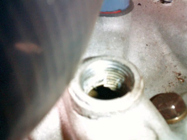

Heres a thought could it be that silly metric system again??
Its Sae or Pipe , tube threads and you are looking at metric fittings . Got a pic ?

« Reply #6 on: April 11, 2008, 06:55:02 am »
Here ya go,sorry for the quality pic im using the stoneage camera.. ;D

« Reply #10 on: April 11, 2008, 01:15:22 pm »
Yes its 1/2" NPT (same size as the plug in the cylinder head) and the smaller ones are 3/8" NPT.  Use a brass allen head plug, it will seal better and the plug will strip out before the manifold does.  I tried using a set of galvanized steel plugs from AutoZone all over my engine.  Every single one of them leaked no matter how tight (yes I used a thread sealer).  Replaced them all with brass, no problems now.  Also the sealer I used was teflon grease from ARP.
