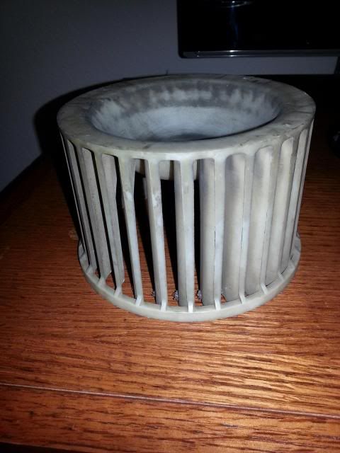

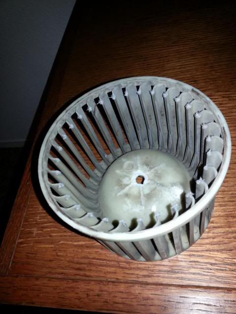

December 07, 2013, 03:31:28 pm »
here a pic maybe that will help. i stopped at the parts store and they don't carry them in stock.
Posts: 19255
Re: Still no blower motor updated pics
Reply #70 on:
December 07, 2013, 04:39:09 pm »
Where are you located?
