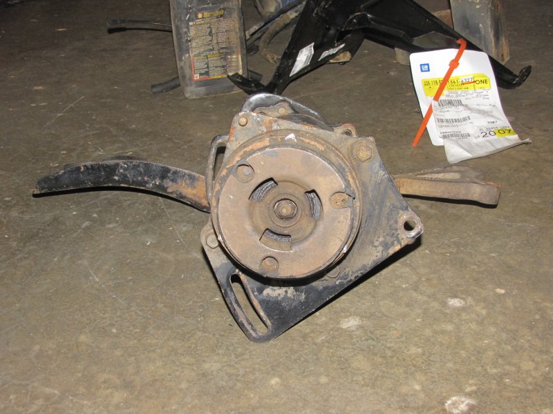

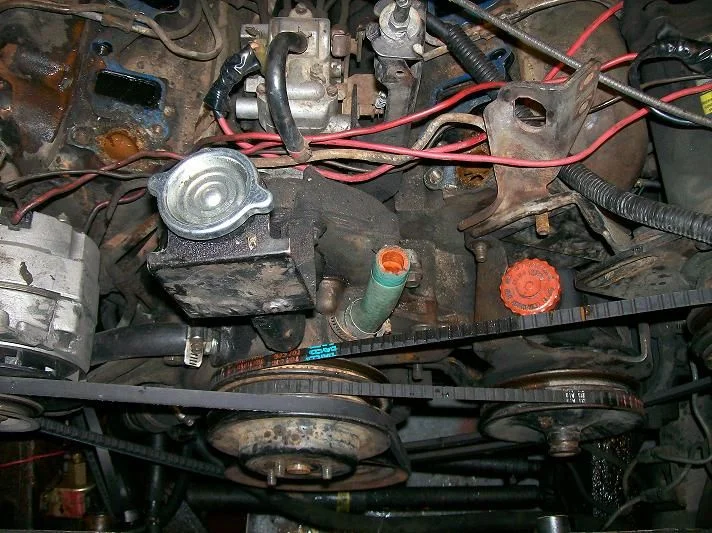

Based on your scan and this picture of the front of mine it looks like I am missing the lower piece that bolts to the head, the 2 rear ones are in the previous pics mounted to the compressor, and can be seen here also.

Junkman.  My Blazer came with a 350 that I pulled out, the Diesel I got for it came out of a M1008 Military truck, it never had AC.  My truck originally came with a R4 compressor.  Vile supplied the A4 Compressor and brackets.
The images I uploaded are from the internet, this is what I currently have as far as brackets.
